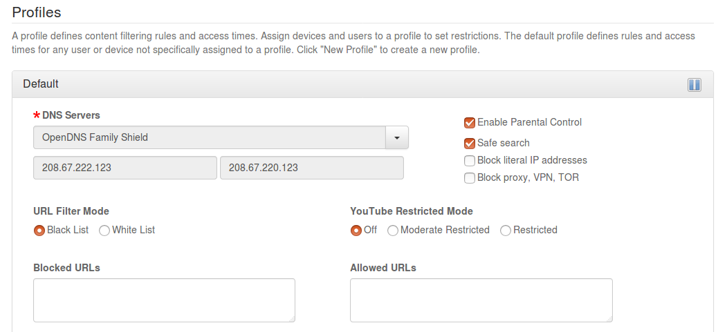

    Open the Access Control page, in the profile you want to turn on Safe Search, check the “Safe Search” checkbox, then click Save at the bottom of the page.
    Safe Search
    After you do this, Safe Search should be turned on for Bing and Google. Yahoo doesn’t support Safe Search over HTTPS. So you need to block Yahoo search: enter either search.yahoo.com or https://search.yahoo.com in the “Blocked URLs” box.
    Ideally you need to block other search engines as well.
