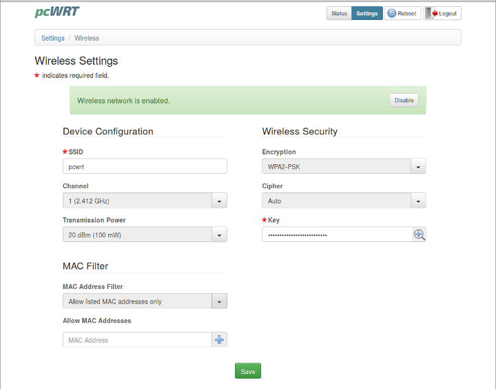

    In addition to setting SSID and wireless security, the Wireless Settings page allows you to:
    • Enable or disable wireless network.
    • Change the wifi channel.
    • Change wifi transmission power.
    • Set up MAC address filtering.
    Wireless Settings
