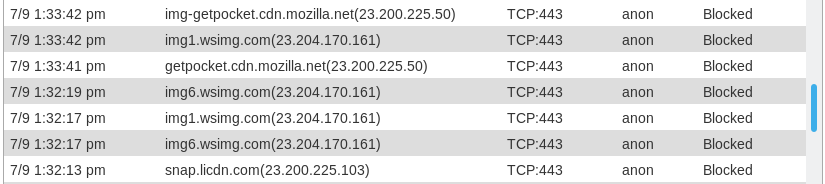

    I have tried and failed to block large ranges of addresses. For instance, I tried to block 23.192.0.0/11 using the blacklist and it has no effect. I’m constantly getting scanned by something on one of 4 servers including one in this CIDR range. I still need to setup a computer firewall to drop them. My efforts in the router failed.

    Once a browser is opened, regardless of the activity/inactivity/website visited I noticed there was a large volume of data transferred constantly to one of 4 CIDR servers. Upon searching these, they show up in some known ads block lists. They primarily pull encrypted packets across HTTP. Even with HTTP disabled in UFW, it was still transfering hundreds of megabytes every few seconds. I finally blocked all of the TCP connections with an IPTable filter that blocks all the ranges, including incoming, outgoing, forwarding, and established. I can still see the dropped UDP packets in my log. They have random IP addresses in the CIDR range and they do odd things like lots of invalid addresses. At least as it is logged the IPV4 address is transposed into a IPV6 in random ways, and otherwise incomplete addresses are used. I thought perhaps the entire issue was some addon, but it happens even when these are removed. Blocking all of these addresses has no effect on the websites I visit. Using Whois on the IP ranges shows nothing about my ISP. I know their IP and servers from browsing shodan. The servers in question are all in the US but none are even in my region. The most common block of addresses sometimes resolves as Amazon aws in logs and the server is registered at MIT. The logs show a udp packet dropped around every 3 seconds. I had rather block this traffic from the network completely if possible. I have Firefox containerized, so the traffic is killed as soon as I close the browser. I just made the switch to Fedora Silverblue as well, so I KNOW I’m in control.

    @jake This does not sound like normal browser behavior. Does this happen to all your browsers across all platforms?
    On the router you can enter the CIDR IP address range as 23.192.0.0/11! in the black list. This is the “force block” syntax. I.e., both direct IP address requests as well as domains resolving to these IP addresses are blocked. More info on the black/white list syntax is available here: https://portal.pcwrt.com/blog/2020/01/how-to-allow-or-block-web-sites-on-the-router/.
    #4010
    Just FYI. Some of the IP addresses in the IP address range 23.192.0.0/11 are those of CDNs. Blocking this range will break some websites. For example, msn.com.
