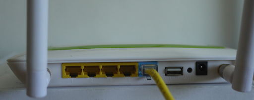

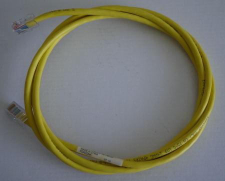

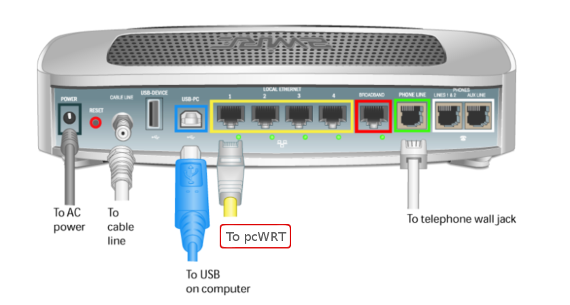

    1. Get out your Ethernet cable.
    2. Connect one end to a LAN port on the AT&T 2Wire gateway.
    3. Connect the other end to the WAN port on the pcWRT router.
    4. Connect the power adapter cable then power on the pcWRT router.
    5. Follow the initial setup instructions to set up pcWRT.

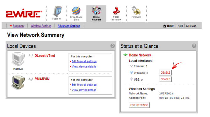

    Here’s how to turn off wifi for the AT&T 2Wire gateway:
    1. Open a web browser on a computer connected to the AT&T 2Wire gateway. In the address bar, enter: http://gateway.2wire.net
    2. Click the Home Network tab. Under Status at a Glance, click the DISABLE button, then confirm.
