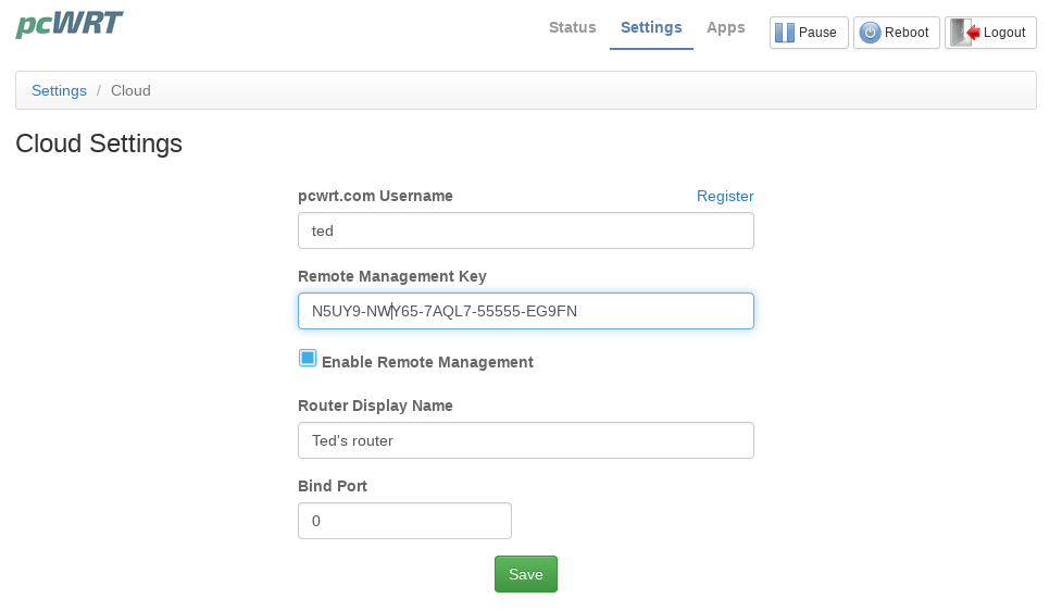

    2. Click Settings at the top right corner, then click Cloud.
    3. Enter your username and the “remote management key” for portal.pcwrt.com. If you don’t have one, click the register link to create an account. You need to copy the “remote management key” from the Manage page on portal.pcwrt.com.
    4. Check the Enable Remote Management box, enter a name for your router, then click Save.

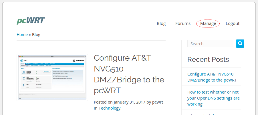

    After remote control is enabled, you can manage the router remotely by logging on pcwrt.com and click the Manage link.
    Remote manage
