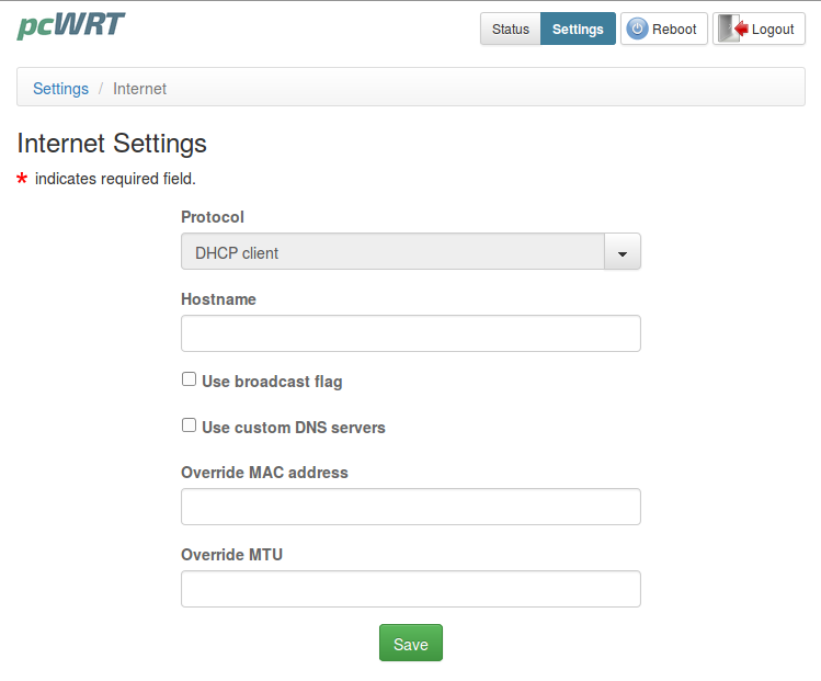

    The most common way to connect to the Internet is via DHCP. Normally it should just work once you connect the router to the DSL or Cable modem. If not, then you need to edit the Internet settings.
    Once you click the “Internet” icon, the screen looks like this:
    Internet - DHCP
    If your ISP (Internet Service Provider) verifies the MAC address of your router, you might need to enter the MAC address of your current router into the “Override MAC address” field. Or, you can call to inform them that you installed a new router.
    If your ISP gave you a username and password to log on in order to connect to the Internet, you are probably connecting with what’s called PPPoE. Select PPPoE from the “Protocol” dropdown, then enter your username and password:
    Internet - DHCP
